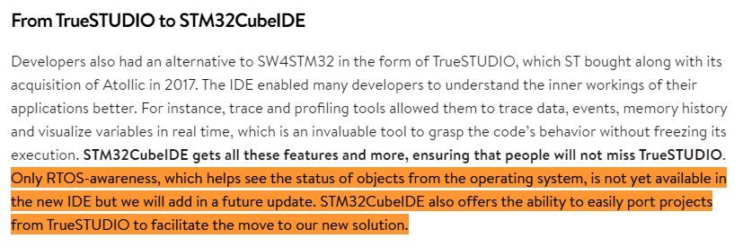

CubeIDE does not yet support the freeRTOS eclipse plugins. I think some persons have been able with third party plugins but not sure which ones.
source :
https://blog.st.com/stm32cubeide-free-ide/
If you need freeRTOS plugins you better stay with TrueStudio for now.
source :
