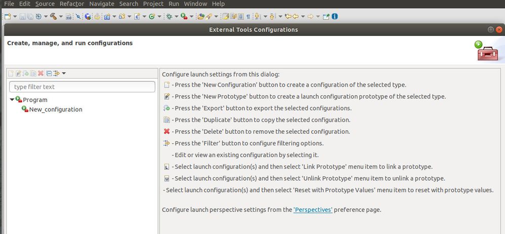

The run button has no defined configuration:
2020-07-11 10:08 AM
That's the "External Tools" button. The run button is different, and hidden from your view.
It looks like you're on an old version of STM32CubeIDE which did not have the run button functionality. The latest is v1.3.1.
The "Debug" button will also upload the current configuration to the device.

I updated to the latest version.
The download page doesn't show the latest version in the drop-down, but if you click the link, you get it.
Thanks, I have my button now.
