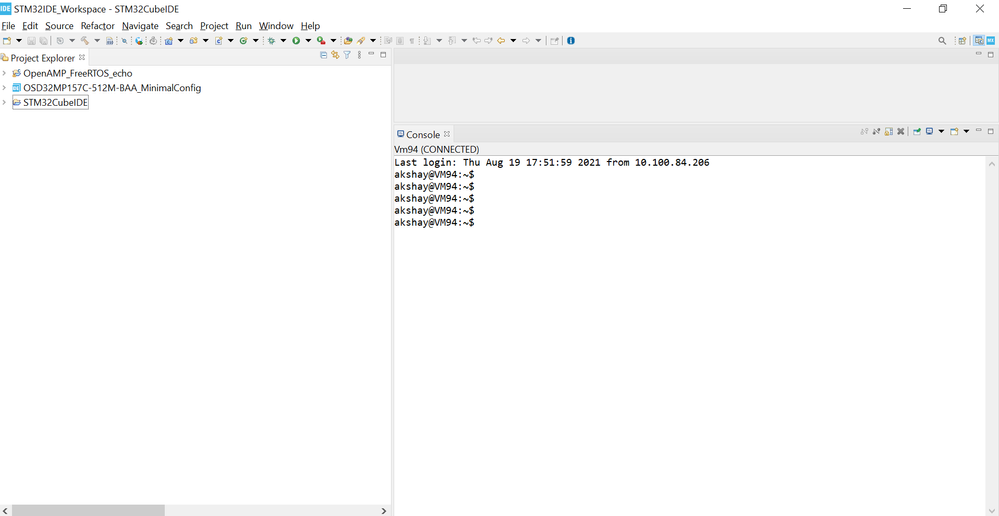

Actually iam using stm32mp1 processor , so i want to modify the example M4 projects using STM32CUbeIDE which are present in linux Distribution package .
which is present in linux virtual machine which i can access only using SSH.
so i have created remote connection in STM32Cube IDE ,iam able to access the console of remote connection but iam unable to find any directory in project explorer.
FYI : the projects already present in project explorer are not from the virtual machine
