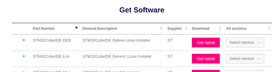

However I solved with the ‘generic Linux installer’ instead of the ‘debian installer’.
Thank you
2023-08-06 11:39 AM - edited 2023-08-06 11:43 AM
I ran into a similar problem on Ubuntu 23.04. I don't have python 2.7 and don't really want to install it as this version is long dead.
There are two installers, avoid the debian one and try the generic linux one:
After unpacking/installing - I ran the `./stm32cubeide_wayland` option. Not sure if this debian 12 is on wayland by default now but it works for my Ubuntu 23.04 install
