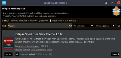

Try load and use Eclipse plugins from Menu -> Help -> Eclipse Marketplace and search by keyword: "color".
You can try the "Eclipse Spectrum Dark" theme, it may meet your needs (with better contrast).
Open "Help" > "Eclipse Marketplace", Then search "Dark Theme " in the search box and Install "Eclipse Spectrum Dark Theme". It's recommended to restart the STM32CubeIDE.

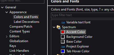

Check in Preferences > Appearance that "Spectrum" dark theme is added.
