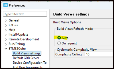

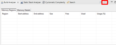

Hi @Pavel A.
I just tried your suggestion, and when the "auto" is turned on, the refresh button is disabled:
turning off "Auto" re-enables that button, but I still have the original problem of the build analyzer not updating.
Either the build analyzer window is blank, or it is using data from an older compile.

Hello @matt-crc ,
I suggest that you refer to UM2609, section 2.5 where this new button is explained and how you can change the behavior.
Thanks.

2025-03-10 12:57 AM
I figured out the button settings as per section 2.5 of your manual... But the main problem is getting the data.
In Auto Mode, the build analyzer does not update
in On Request mode, the build analyzer does not update with the refresh icon.
Do you know how to get the Build analyzer to work reliably?
