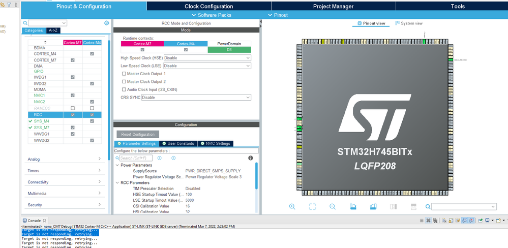

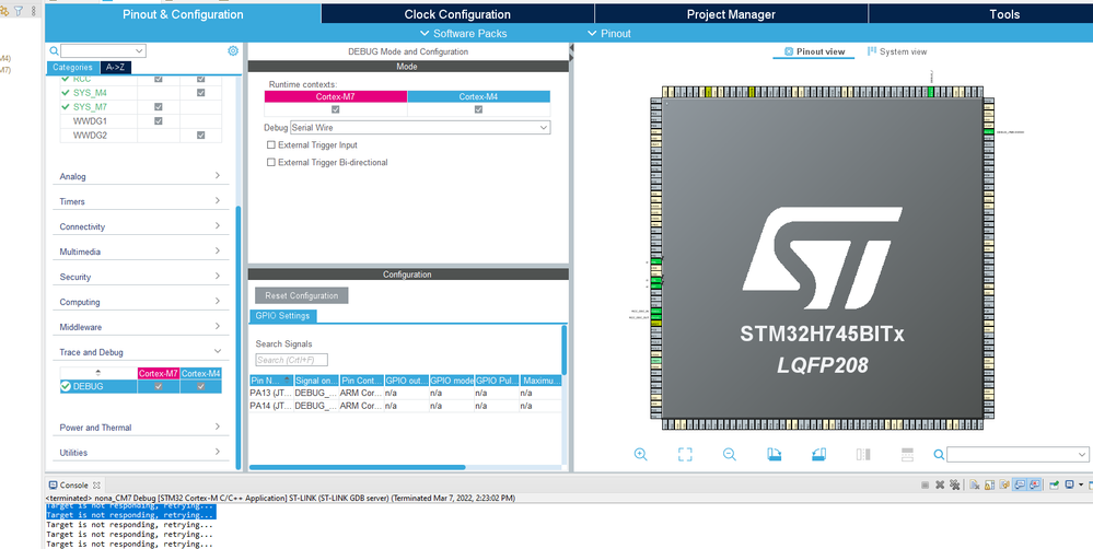

problem:
2022-03-07 11:36 AM
Suggests it is reading 0xFFFFFFFF from one of the vector tables, as you've written FLASH section for one of the cores, and not the other.
Other tools merge the M4 .HEX into the M7 .HEX before writing the combined image.
2022-03-07 11:39 AM
hi Tesla,
thank you for replay, i where can i find the option to write FLASH selection for the second core?
i have been struggling with this problem for 2 weeks.
