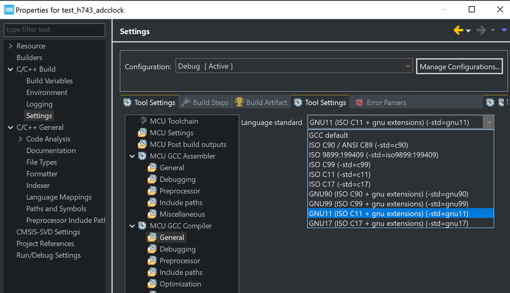

2021-07-29 12:42 PM
For K&R C you'd need the uint8_t i; outside of the for statement and at the beginning of a compound block, ie immediately after the opening brace {
2021-07-29 1:19 PM
Go into your project properties and make sure you're compiling with C99 or later. Not sure why yours got changed.
2021-07-29 1:45 PM
Thanks TDK, that did the trick. Compiles fine.
