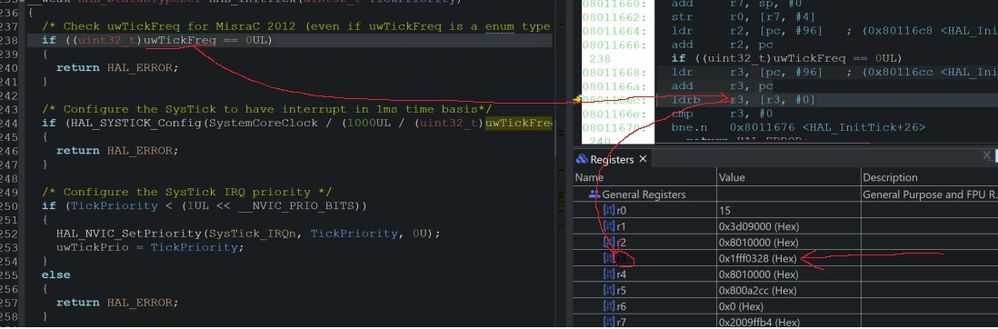

2023-08-11 8:24 AM
Another Update: regarding my first firmware, the one with -fpie, I now notice that the disassembly loads the global offset table exactly 0x10000 away from where it is actually located. 0x10000 is coincideentally the offset at which I load the firmware with respect to the original linker placement....
So I wonder, it looks like the program expects the GOT to be placed relatively to the PC with a fixed offset, but if the firmware gets uploaded in a different place than the linker's expected location, the GOT location calculated in that way becomes invalid.
What is the point of having position independent code if the global offset table is loaded in a position-dependent manner?Am I missing something?

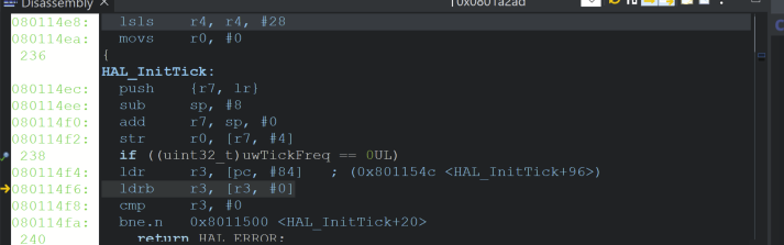

So, the problem now seems to be that static variables are somehow not listed by the .got.
When trying to access one of these static zero-initialized variables (so living int he .bss section) , the program goes into hardfault because it loads it from the wrong address.
This is the content of the .got section and since .bss starts at 0x20000f20 and ends at 0x200015d8 you can see several entries belong to the .bss section, but others do not appear, like this one below

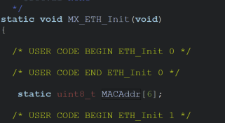

Which is this static array
When the program tries to access this variable it does so at 0x1fff15d8 whic is exactly 0x10000 away from where it actually is ( and 0x10000 is the offset by which I upload the code to test the position independence).
This is because said variable is loaded by adding an offset to the program counter PC, if it were to be loaded via GOT this would not happen!
So why are local static variables not addressed via GOT while global variables are? is there a way to ensure GOT coverage for all static variables?
