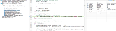

Hi
I am trying to launch debug for TrustZone enabled setup but when NonSecure_Init() function hit in secure region instead of jumping into Nonsecure region . it's giving hardfault handler.

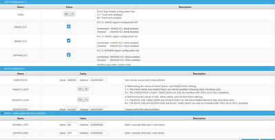

Also can I know what are the configuration settings to be done in STM32CubeProgrammer for my application to run in both secure and non secure correctly.
I suspect the issue seems to be because of settings in STM32cubeprogrammer.
Can anyone help me configure correct memory allocation and settings to be done for TrustZone enaled secure-NonSecure to work without trouble.

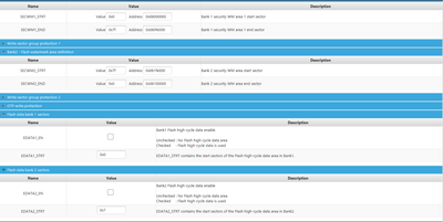

Hello @Riya and welcome to the community,
The problem of the NonSecure_Init() function hitting the secure region instead of jumping to the non-secure region is due to improper memory allocation of secure and non-secure.
According to your configuration, it looks like both your banks are configured as secure. Try to change this:
SECWM2_START value = 0x01
SECWM2_END value = 0x00
apply and save and try to debug.
Check your jump address in the secure firmware, it should be the start of your bank 2 address 0x08100000UL, which is not the case as your CubeProgrammer configuration is for bank 2.
Hope this helps!
