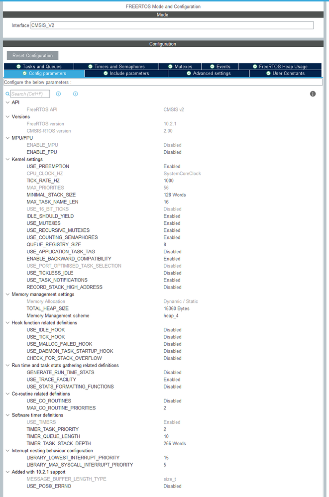

I use STM32CubeIDE, and setup the RTOS as mentioned in the guide (by pretty much just enabling it and doing nothing more).
I have attached pictures of the settings below aswell:

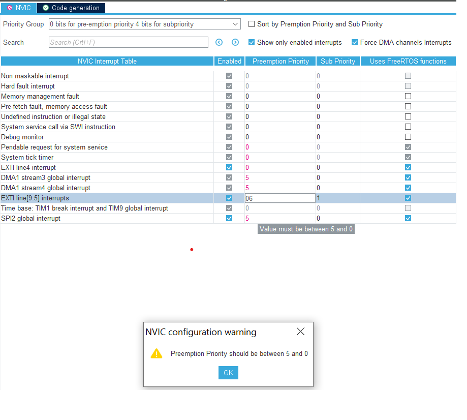

Then I go to sys, select my form of debugging (5 pin SWD) and chose another timebase source (TIM9).
When I generate code, the IDE shows errormessages regarding my current interrupts, as these have preemption levels under 5. They should be within 5-15 due to the RTOS, but these can't be changed from the GUI.
So I navigate my way into the automatically generated code, and set the priorities myself.

Hi @Ons KOOLI
In the meantime I tried making a IOC file, where I copied all my settings, but added the Free RTOS first. Then I inserted all my old code, and I am now able to run different tasks and my interrupt service routines aswell (all with preemption priority 5). I think it got messed up because I added the RTOS to an existing project, where the interrupts were configured with a preemption priority below 5.. Weird I couldn't change it..

Hi VSøby.1,
I don't think so. In STM32CubeMX/STM32CubeIDE you can change priorities even if you add FreeRTOS to an existing project.
I think it is caused by another issue.
