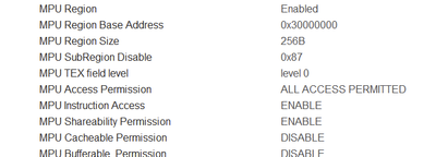

2024-08-25 2:57 AM
As per AEfth response (solution), anybody using an STM32H7xxx needs to read this article if they are planning to use DMA:
https://community.st.com/t5/stm32-mcus/dma-is-not-working-on-stm32h7-devices/ta-p/49498
Unfortunately DMA does not (always) work out of the box even though STM32CubeMX gives you the impression it is all configured.
To try the solutions from this article I connected USART1 TX to UART5 RX pin and enabled DMA on both. I then used a terminal to send characters via DMA from USART1 to UART 5. All the solutions in the article worked on my STM32H743VITx chip.
If I enable Dcache (SCB_EnableDCache()) I get invalid characters on UART5, disable it and all is OK. This is solution1 in the article but only if you use the 2024 linker script, for the 2019 script you need to make the RAM_D1 region changes as described in solution1. Disabling dcache is unlikely to be a solution as most users (incl me) picked the H7 for performance reasons.
Next I tried solution3 (dcache enable + cache management), this also worked. I simply place SCB_CleanDCache_by_Addr() call before the DMA transfer:
SCB_CleanDCache_by_Addr((uint32_t*)(((uint32_t)txbuffer) & ~(uint32_t)0x1F), 16+32);
if (HAL_UART_Transmit_DMA(&huart1, txbuffer, 16)!=HAL_OK) ...The final solution2 (which is what I am going to use) is to use MMU to create a small memory hole for the DMA buffers in RAM_D2 with the dcache is disabled. This is easy to do using STMCubeMX and also worked.
The only change I had to make was to initialize the DMA buffer as there is no default initialization (as mentioned in the article),
Regards,
Hans.
