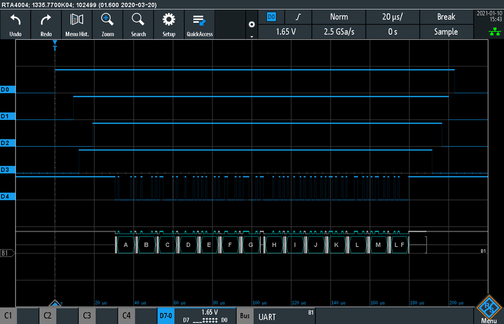

Thanks for your reply. I have already seen the syntax of __HAL_UART_ENABLE_IT and totally agree that there is no logic for this to block. However, let me give more details.
Main loop:

}Result (D0...3 is the state of OUT_0...3; D4 is the Tx pin):

2021-01-10 7:08 AM
Thanks TDK, this was a super fast solution! I wasn't aware of the fact that HAL_UART_IRQHandler gets called after every character transmission as well, I was erroneously supposing it only gets called once at the end of packet transmission.
HAL_UART_IRQHandler takes ~11us @ 16MHz so this explains why I was stuck with 921.6kbps.
