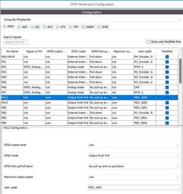

I am using the STM32CubeIDE software and have configured all GPIOs. I having trouble with PA12 and PA15 in particular. See GPIO Mode and Configuration:
I use pin PA12 (MD1_AIN1) and PA15 (MD1_AIN2) for the choose the direction for a DC motor.

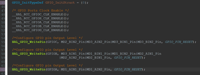

In the "gpio.c" file I have the following code:
As seen both PA12 and PA15 should be RESET = LOW.
Here is the configuration further down in the code:
I have tried writing:
HAL_GPIO_WritePin(GPIOA, MD1_AIN1_Pin|MD1_AIN2_Pin, GPIO_PIN_RESET);
also in the main.c file but did not seem to work.

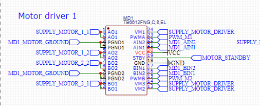

See drawing for motor driver:

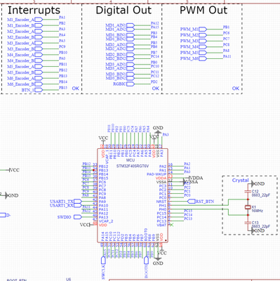

Drawing for MCU (under Digital Out):

1. Which part are you referring to? I am able to program the MCU yes, I have tested PB15, which is a button and it works fine.
2. As you can see in the image below I do not use the VCAP pins. Is this necessary?
3. If you mean the MCU orientation, yes it is correct.
4. Yes.

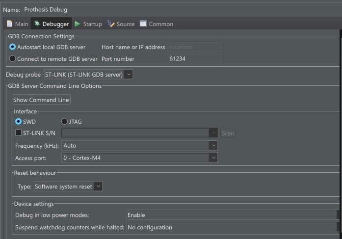

5. Do you mean the Debug Port for SWD/JTAG?
I am using an ST-Link V2 which is connect via SWD.
Here is my debug configuration:
Thank you.

2024-05-04 3:01 PM
Hey @Tesla DeLorean!
I did as you suggested and connected the VCAPs with a 4u7 F capacitor.
This seemed to solve my problem.
Thank you very much for your help!
