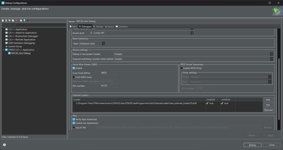

i didn't use rtos in the code used to generate the external loader but i use it in the code that will be running in the external flash can i do that or not ? and when i enable the external loader in cube ide like the photo the problem above start to happen when running the code even though i didn't specifiy any code to be uploded in external flash in linker script yet and even the all the code sections is running from my stm32 h750 internal flash ,just enabling it dose this problem and i think the initialize option that marked in the photo is the reason because it make the startup code change the address of vector table or something don't know really why is this happening
