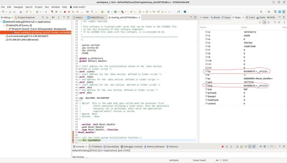

Here you can see, that SP for HAL_UART_RxCpltCallback is at 0x20000104
This is definition of global variable nmea_head. On the right side you can see, that it was placed on the address 0x20000110. This address overlaps with stack frame of HAL_UART_RxCpltCallback, so my variable gets corrupted. What am i doing wrong?

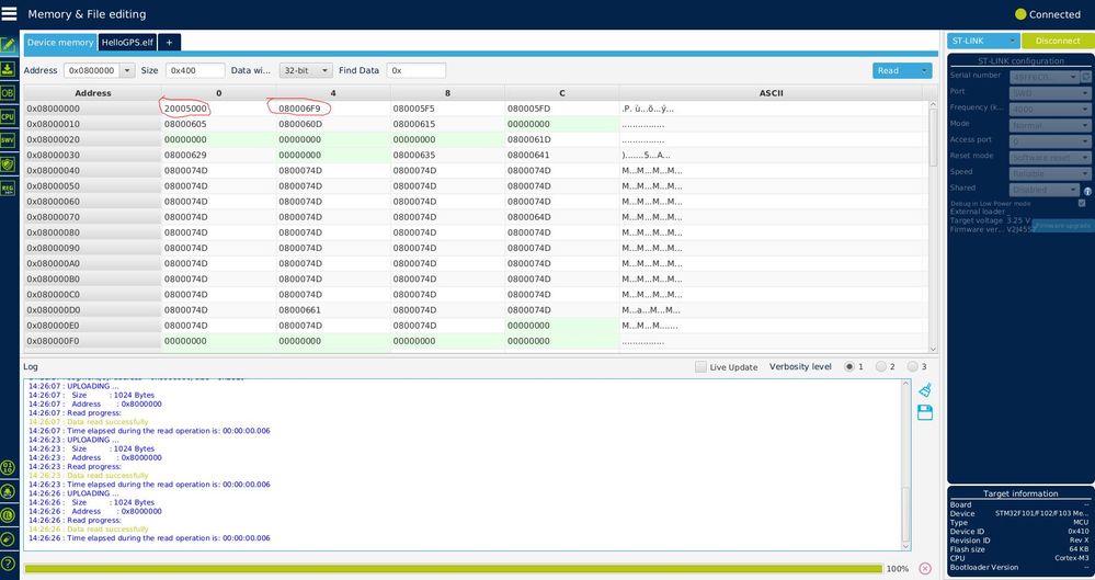

I checked memory with STM32CubeProgrammer
0x20005000 is correct value for _estack and 0x080006f9 is address of ResetHandler

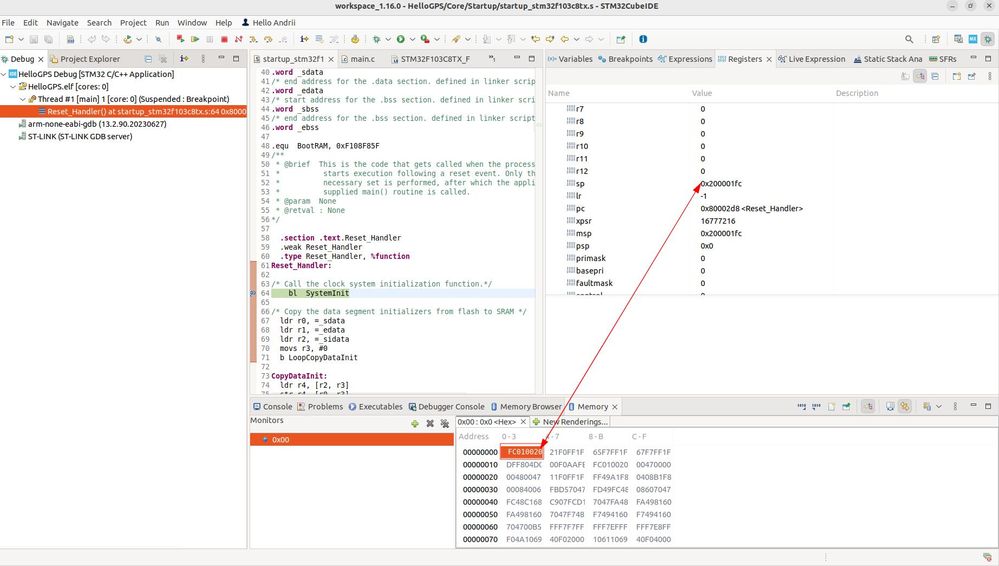

So this should mean, that chip should start directly at Reset_Handler without any prior bootloader and msp/sp values should be 0x20005000, right? Because when i break at reset handler i see something different:
2024-08-01 5:38 AM - edited 2024-08-01 5:40 AM
I ckecked memory during after reset:
This is why i have invalid SP/MSP. But where does this value come from?
