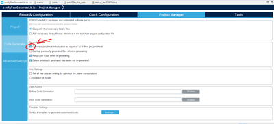

2024-01-23 2:51 AM
I finally found out a solution.
In order the project use the good HAL_UART_MspInit.
I had to generate peripheral initialization as a pair of '.c/.h' files for each peripheral.
It can simply be done by checking a box in the .ioc file of the library.
Prject Manager > Code Generator > Check the box "Generate peripheral initialization as a pair of '.c/.h' files per peripheral"

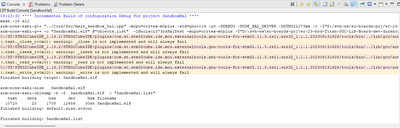

I also notice some errors which appear only during the first compilation:
(_write is no more in compilation error thanks to the previous definition)

Hello @YohannDrc and welcome to the Community :),
Concerning the built errors issue, could you please try to downgrade the toolchain version to the GCC10.
For more details, take a look at this post.
I hope this help you.
Thank you.

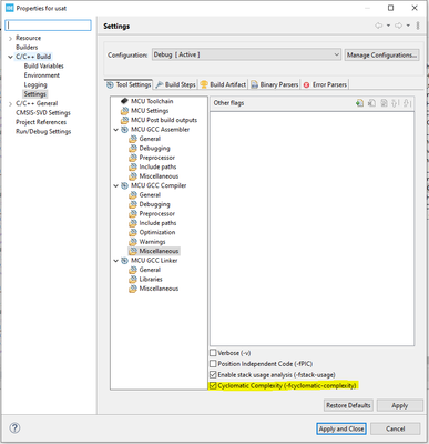

But I now have this message :
arm-none-eabi-g++: error: unrecognized command-line option '-fcyclomatic-complexity'
2023-11-15 3:25 AM
Hi @YohannDrc ,
Thank you for updating the post.
Could you please check the Cyclomatic Complexity functionality.
For more, details please refer to UM2609 Section 10. Cyclomatic complexity.
Thank you.
Kaouthar
2023-11-15 4:49 AM
So I uncheck the Cyclomatic Complexity functionality and I can no compile without error message.
