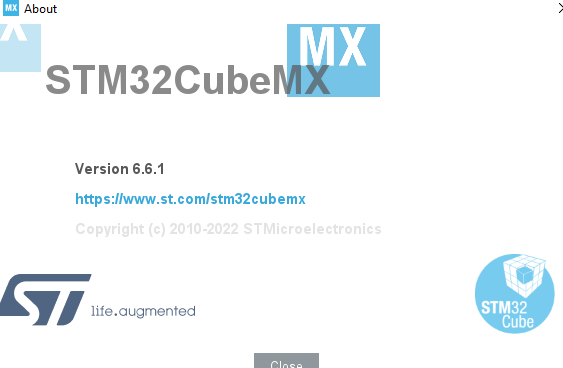

I am using cubeMX 6.6.1.
When selected FREERTOS cmsis-v2 and FATFS, everytime cubeMX generates code it oveerrides syscall.c with FREERTOS cmsis-v1 prototype funcions.

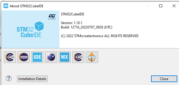

Good morning @Javier Muñoz
I recommend you to use stm32cubeide version 1.10.1
It is the latest version and your problem will be resolved

@Ghofrane GSOURI I just downloaded the 1.10.1 CUbeIDE
And as i expected ,the issue is still there, this has nothing to do with the Cube IDE,
Same thing could be detected using a plain text editor.
When generating the boiler plate code wth CUBEMX , when freertosv2 is selected, CUBEMX uses old freertos v1 function definitions in syscall.c causing this error.
