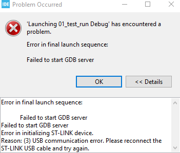

After updating to STM32CubeIDE 1.14, I can't program my custom boards or Nucleos. I have tested three Nucleos.
Debug probe STL-LINK GDB server -> fails. All custom boards and Nucleos give me the same error, as seen in the image below.

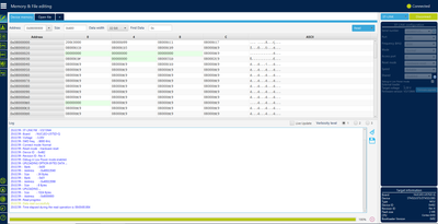

STM32CubeProgrammer works fine.
I have reinstalled all programs a couple of times, but I keep getting the same error.
Any ideas?

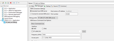

2024-03-16 4:59 PM
Try to create new debug configuration for STL-LINK GDB server, rather than reusing configurations created before update.

2024-03-16 5:05 PM
Try to create new debug configuration, rather than reusing configurations created before update.

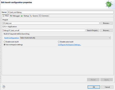

2024-03-16 6:14 PM - edited 2024-03-16 6:24 PM
Hi Pavel
I deleted the .elf file, a new one is created when start a new debug/run sesions, it is Ok or I should try something else? After that problem persist.

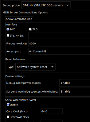

> Debug probe OpenOCD -> works fine on all boards and Nucleos.
So why not use this ? (I most times use OpenOCD .)
> initConfigParams(): cpu-clock 800000
CPU is at 8M - really ?
see one of my settings with GDB:
2024-03-17 8:02 AM
@dhs Not the .elf file. Create a new debug configuration. Do not delete the old one yet, if you prefer.
2024-03-17 10:52 AM
Hi Pavel
I creted a new one and I still getting same error.
