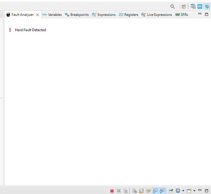

STM32F030.
STM32CubeIDE v1.13.0.
I've hit a Hard Fault:
But the Fault Analyzer tells me nothing:
Where's all the other info?
Also, I don't see the promised toolbar buttons anywhere:

Hello @Andrew Neil ,
Fault analyzer toolbar is no more available but not the fault analyzer feature, which is still available but, in your case, you are working on a cortex M0 based microcontroller (STM32F0) so no fault related registers are available and no fault analyzer view subsequently for other cortex M4 -M33 -M7 you can still have the full view of the fault-analyzer.
