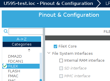

No - i just try new U595 project, can select FileX ( the part of Azure you need for FAT on SD..)
and ThreadX , if you want (= Azure rtos )

2024-01-03 4:49 AM - edited 2024-01-03 4:57 AM
2024-01-03 10:14 AM
That is it, thank you so much! I was misunderstanding what you meant but it is clear now. Much appreciated
