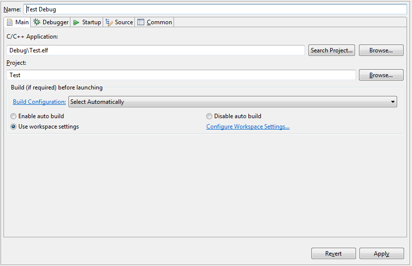

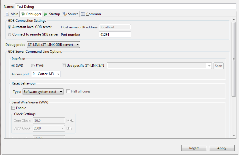

Hi, I could connect the board using STM32CubeProgrammer and I dont change anything in Debug Configuration. But when I click Debug, it showed the error like above. Here are some pictures that show the debug configuration:

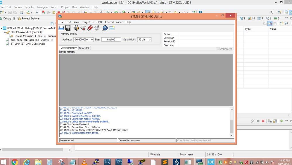

> check cable and try changing the port if it still exists then do the following steps, I solved by this way.
Download this ST-Link Utility from ST website as shown in figure

I had actually switched to jlink using the ST-reflash utility and when I restored the ST-Link it was not getting detected in stm32cubeide. But these steps fixed the issue.
