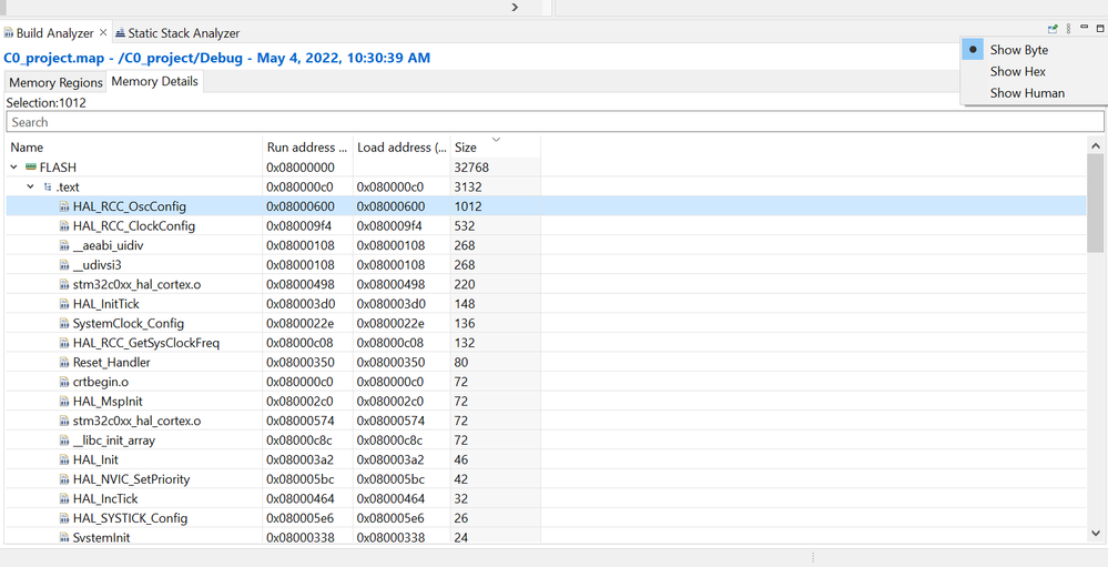

To add to what Andrew mentioned, to see what consumes the most memory of your application you can use the Build Analyzer inside STM32CubeIDE. Choose "Show Byte" and sort by the "Size" column as shown in the screenshot below:

Ironically the screenshot also clearly shows how bloated the HAL is - the clock initialization with HAL_RCC_***() and some companion functions wastes 2 KB of flash.
