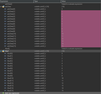

I have tow arrays one named adcData[] that is adc input buffer and Xbuf[] that is output buffer. Now i am calculating some paramaters... But when i use my debuger and Live variables, i get only adcData[] and Xbuf[] is "Failed to evaluate expression". Arrays are declared same way and everything is configured similarly.

Hello @Miha
The issue seems to be linked to the syntax of the variable in the "Live expression"
BR,
Semer.
