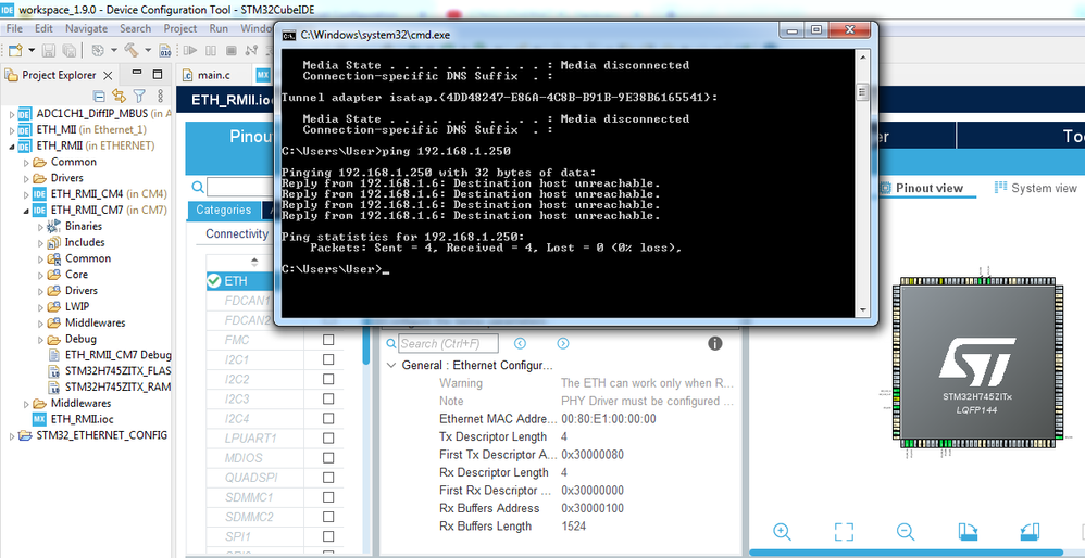

Hello, I have a Nucleo H745ZI-Q board in this am working Ethernet fallowed some examples when doing ping test response is Destination host unreachable(am using CM7 and done memory configuration also).

Hello @sa V.1,
It is recommended to follow the same configuration as in the examples provided in the STM32CubeH7 firmware package
Also, check this FAQ : https://community.st.com/s/article/FAQ-Ethernet-not-working-on-STM32H7x3
Hope that helps!

2023-09-04 10:28 PM
Ethernet configuration and ping test done . Ping Test successfully ping's .Next i want send data from PC to Board or receive data How and where should i process(in code - function )the data and how should i achive . checking ping test in command prompt .
