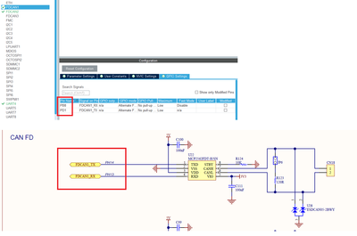

After checking your .ioc file, you're configuring the wrong GPIO pins for FDCAN1 (PB8 & PD1):
According to the board schematics, you need to set:
PH13 for FDCAN1_Tx and PH14 FDCAN1_Rx.

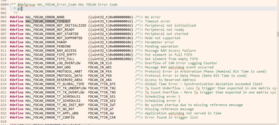

If there is an error, you can check it in the error callback.
void HAL_FDCAN_ErrorCallback(FDCAN_HandleTypeDef *hfdcan)
uint32_t error;
error = HAL_FDCAN_GetError(hfdcan);
2024-03-21 1:20 AM
Thank you for the advice! I implemented your code and was able to see the error code: 512 (HAL_FDCAN_ERROR_FIFO_FULL). Any idea what could be the cause of it? How do I solve it?

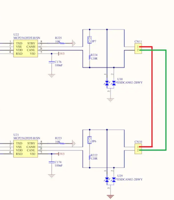

How did you connect FDCAN1 to FDCAN2?
2024-03-21 1:47 AM
2024-03-21 2:04 AM
Thanks for sharing these materials.
One more question: did you fit JP6 and JP7 in order to connect termination resistors of 120 ohm?
2024-03-21 2:17 AM
Yes, I do have the termination resistors connected.
2024-03-21 5:06 AM - edited 2024-03-21 5:25 AM
2024-03-21 5:53 AM
@Nick_Tesla please confirm if it was an issue of pin configuration.
