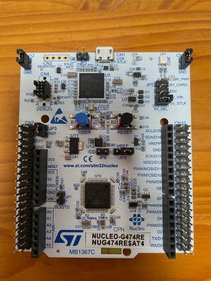

I have a NUCLEO-G491RE board connected to a PC running STM32CubeIDE v1.17.0. On first connection I was prompted to update the firmware on the board, which I did. On successful completion of the update I disconnected and reconnected the board, but the download failed with the attached message.
I have tried several USB cables and also with and without an intermediate USB hub to eliminate these possibilities.
What is the solution please?

Hello @alw ,
Further to the picture provided on message. I recommend that you change the jumper on CN11 to JP6.
Thanks.
Mahmoud

Problem solved, it was just jumper link settings.
JP5 (5V_SEL): 5V_STLK
JP6 (IDD): On
JP7 (BOOT0): Off
Suggestion, rather than the error messages that are provided, have ones that advise users to check thatthese links are correctly fitted.
