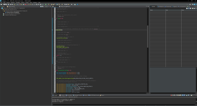

I have a NUCLEO-G491RE board connected to a PC running STM32CubeIDE v1.17.0. On first connection I was prompted to update the firmware on the board, which I did. On successful completion of the update I disconnected and reconnected the board, but the download failed with the attached message.
I have tried several USB cables and also with and without an intermediate USB hub to eliminate these possibilities.
What is the solution please?

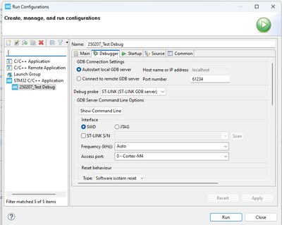

2025-02-07 5:12 AM - edited 2025-02-07 6:25 AM
Hello @alw ,
Further to your comment, I was able to launch the debug session using the STM32CubeIDE Project that you have attached.
I suggest please that you provide the debug configuration.
Thanks.
Mahmoud
