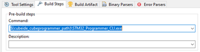

2023-09-25 12:25 AM
Hello @FBL,
if I try to add the following pre-build step, as indicated in the post:
STM32CubeProgrammer is launched correctly, but only dumps the cli usage syntax.
make -j7 all
C:\ST\STM32CubeIDE_1.11.2\STM32CubeIDE\plugins\com.st.stm32cube.ide.mcu.externaltools.cubeprogrammer.win32_2.0.500.202209151145\tools\bin/STM32_Programmer_CLI.exe
STM32CubeProgrammer v2.12.0
Usage :
STM32_Programmer_CLI.exe [command_1] [Arguments_1][[command_2] [Arguments_2]...]
Generic commands:
-?, -h, --help : Show this help
-c, --connect : Establish connection to the device

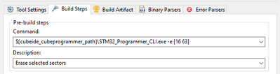

However, if I append the command to erase selected sectors of flash
I have the following error:
make -j7 all
C:\ST\STM32CubeIDE_1.11.2\STM32CubeIDE\plugins\com.st.stm32cube.ide.mcu.externaltools.cubeprogrammer.win32_2.0.500.202209151145\tools\bin\STM32_Programmer_CLI.exe -e [16 63]
c:/st/stm32cubeide_1.11.2/stm32cubeide/plugins/com.st.stm32cube.ide.mcu.externaltools.make.win32_2.0.100.202202231230/tools/bin/sh: C:STSTM32CubeIDE_1.11.2STM32CubeIDEpluginscom.st.stm32cube.ide.mcu.externaltools.cubeprogrammer.win32_2.0.500.202209151145toolsbinSTM32_Programmer_CLI.exe: not found
make[1]: *** [makefile:93: pre-build] Error 127
make: *** [makefile:61: all] Error 2
"make -j7 all" terminated with exit code 2. Build might be incomplete.
What am I doing wrong?

2023-10-06 11:48 AM - edited 2023-10-06 11:53 AM
From the log above, the built-in "sh" utility (busybox) does not like backslashes. Try somehow to replace all \ to \\ or to / or use cmd in the command: cmd /c "${cubeide_programmer_path}\STM32_Programmer_CLI.exe -e [16 63] "
Maybe the new CubeIDE has a bug in handling of / and \ on Windows - it used to do the right thing.
