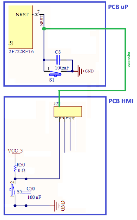

I've solved the problem. It was a hardware short on the uP's NRST. I was misled by the fact that it worked once.
2024-08-24 12:15 PM
Sorry!
I don't understand how you solved the problem.
Can you explain more?
2024-08-26 1:52 AM
My hardware consists of several PCBs linked via connectors. On 2 of them there is a button that allows the uP to be reset. The aim is for the reset to be as accessible on the PCB containing the uP as it is on the one for the HMI.
In the end, the uP reset is connected as follows:
When I press S5, the 0 ohm resistor R50 causes a short circuit on NRST.

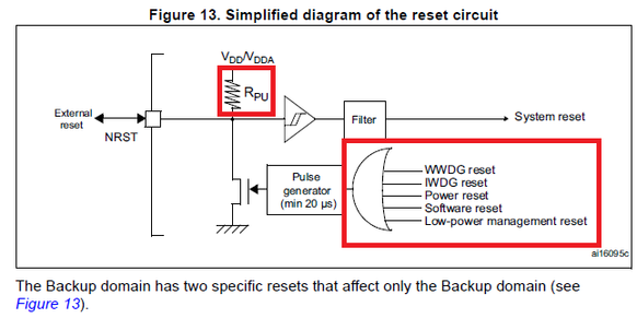

According to the ST documentation, the pull-up resistor (Rpu, framed in red) for the NRST input is internal and fixed, so there is no need to add one.

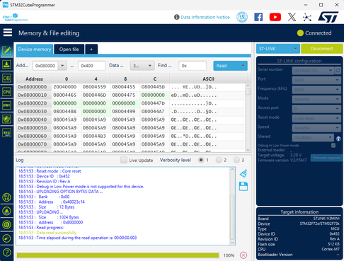

I didn't understand why it didn't work because when I used STMCubeProgrammer I could load the program without any problem.
My intuition is that when using STMCubeIDE, at the time of debugging, the uP activates one of these outputs (framed in red) and pulls the transistor to ground. This causes the internal reset but it also causes the short-circuit due to my 0 ohm resistor R50. Conversely, when loading the program with STMCubeProgrammer, the uP does not activate the outputs because it uses the NJRST and this does not cause a short-circuit.
I simply removed R50 and C50 and that solved the problem.
I hope my answer is clear enough.

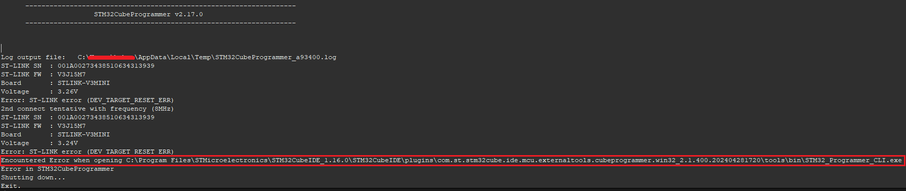

Any solution for the mentioned issue. While I am able to upload the program using STM32Programmer and STM32-Utility , STM32CubeIDE fails with error from STM32_programmer_CLI.exe (when tried to use even from cmd prompt) , reporting from the above mentioned dll.
Even the cmd STM32_programmer.exe --help raises the same error.
Any idea how it could be resolved ?
I am using STM32CubeIDE 1.16 (downsized from the latest ) on windows 7.
