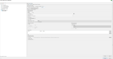

2024-03-06 5:58 AM
Hello @Gaius_baltar_2025
Let's try to go to Debug configuration and change the port number to 61238 this could solve the problem
I will be waiting for your feedback.
Thx
Ghofrane
