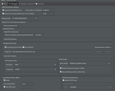

using open ocd :
so removed all , again set only:

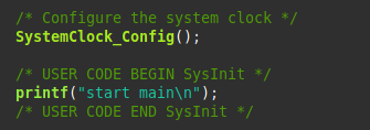

/* USER CODE BEGIN 4 */
int __io_putchar(int ch)
ITM_SendChar(ch);
return (ch);
with:
then it worked...
try it. (but i can promise, it is more hit and hope game ! )

I have just enabled SWD+SWo in Cube, then in debug settings also: enable SWV . + set correct core frequemcy, it will run.
Then in main, just the
ITM_SendChar(ch);
return (ch);
In debug session then, pause, select SWV, ...as you show it on top. + "start trace" .
