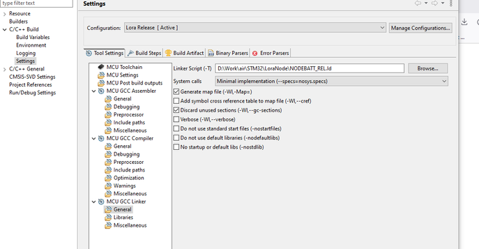

I have an STM32L433CBT processor and created a project using STM32 IDE version 1.14. I created the project on STM32 MX version 6.9.1 . The project works in debug and I created a release version , but the elf file is far too large. I have the following running in the post build steps:
arm-none-eabi-objcopy -S -O binary "Project.elf" "Project.bin"
then use the bin file to program the chip out in the field. For some reason the elf file generated in release is 232KB, and the converted bin is 131,073KB. Compared to previous larger projects where the elf is size 176KB and converted bin is 68KB.
When I build the application I get the following in the console:
arm-none-eabi-gcc -o "Project.elf" @"objects.list" -mcpu=cortex-m4 -T"D:\Work\air\STM32\Project\STM32L433CBTX_FLASH.ld" --specs=nosys.specs -Wl,-Map="Project.map" -Wl,--gc-sections -static -u _printf_float --specs=nano.specs -mfpu=fpv4-sp-d16 -mfloat-abi=hard -mthumb -u _printf_float -Wl,--start-group -lc -lm -Wl,--end-group
Finished building target: Project.elf

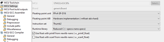

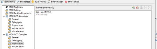

Both projects have the same setup as below:
Preprocessor:
Link setup:

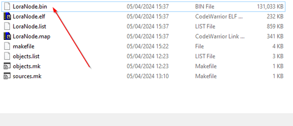

Thanks for your reply. In previous projects I use the the command:
to create the binary to go into the chip , but this time the bin file size is converted bin is 131,073KB , too big for the chip.

2024-04-05 7:33 AM
@SSmit.13 wrote:the bin file size is converted bin is 131,073KB
Really - 128 M bytes ?
2024-04-05 7:39 AM
Hi Andrew
Yes, older projects have been around 68K, see below directory.
2024-04-05 7:44 AM
Ok, so if it is 131MB, it suggests you've got it initializing very distant memory areas, not just 0x08000000 + 128KB to 256KB
Is it describing 0x20000000 or 0x90000000 ? These would tend to approach GB binaries, and the sections would need to be extracted individually, not as a single monolithic image.
DUMP the SECTIONS in the object file.
REVIEW the LINKER SCRIPT, where's it putting things?
UNDERSTAND what getting into the file
