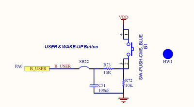

As per the board schematics, User button is active High, so I suggest to replace:
GPIO_InitStructure.Mode = GPIO_MODE_IT_FALLING;
by
GPIO_InitStructure.Mode = GPIO_MODE_IT_RISING;

2024-10-09 1:59 AM
by
