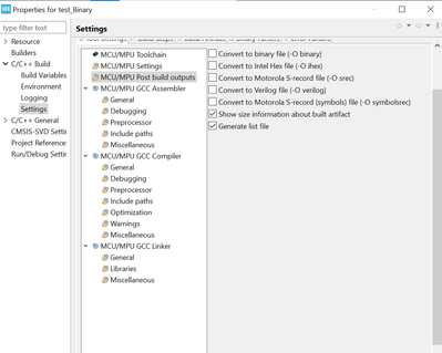

3- Right-click on your project, select Properties, then navigate to C/C++ Build > Settings.
Here, ensure that unnecessary build outputs or post-build actions are disabled, which might reduce the need for searching.
