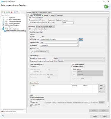

These are the settings:
I already tried the following things:
Any suggestions how to fix debugging with "Autostart local GDB server" ?

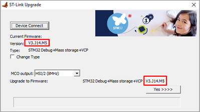

2024-04-04 5:02 AM - edited 2024-04-04 5:10 AM
Hi Rim!
Thank you for your quick response!
Maybe good to mention that yesterday I already sucessfully updated to the latest version of ST-Link as prompted by the IDE (probably when started debugging). It worked perfectly throughout the whole day (did not reboot the PC).
Anyhow, I followed your instruction and downloaded the ST-link upgrade from: https://www.st.com/en/development-tools/stsw-link007.html?dl=redirect . I started the ST-LinkUpgrade.exe tool and the current version match the "Upgrade to Firmware" field:

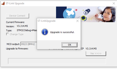

Ran it again with MCO output to (HSI/2 (8MHz)) and got the following response:

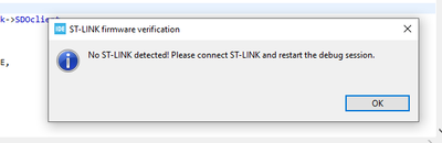

Unfortenately, the error (No ST-LINK detected! Please connect ST-LINK and restart the debug session) still remains:
Any more suggestions?

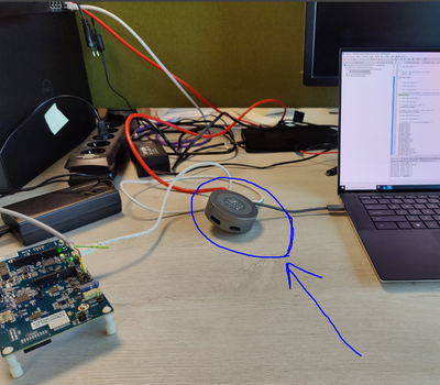

Today I got new insights.
I started this project at my home with a Dell 6-in-1 MultiPort adapter attached to my laptop (since there is only usb-C available on my laptop) enabling the internet/LAN connection and ST-Link connection. This descibes the setup that was working via the "Autostart local GDB server".
When I tried to start this project at work while connected to the docking-station, the "Autostart local GDB server" didn't work. Today I had the idea to bring things back to the original (home) situation at work. See picture below:
Bringing it back to the original setup sovled the issue because the debugger started with "Autostart local GDB server"! Might it be caused by the network-adapter? Can this be set somewhere in a config-file?
