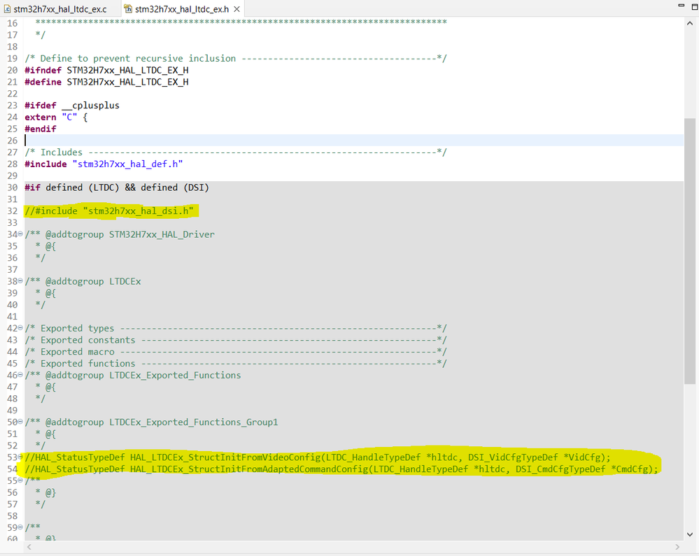

2024-04-04 10:51 PM
I've came across the same problem. Disabling DSI mode via "project_name.ioc", "stm32h7xx_hal_dsi.h" file is not included in project workspace but It seems compiler try to execute this line even DSI mode is not active.
Then I realized there is a code in "stm32h7xx_hal_ltdc_ex.h" file at line 32. "stm32h7xx_hal_ltdc_ex.h" file cannot be reached by stm32cubide workspace but can be manually reached "..\Drivers\STM32H7xx_HAL_Driver\Inc" directory.
I tried to comment out #include "stm32h7xx_hal_dsi.h" line and all function prototypes in "stm32h7xx_hal_ltdc_ex.h" file and build the project "No such file or directory" error no longer exist.
