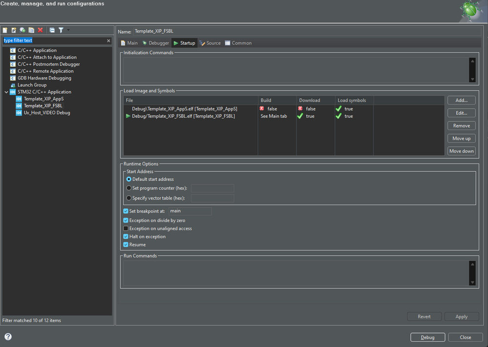

I am trying to debug STM32N6 program loaded in external flash. When I started the debugger in the FSBL project I can put a breakpoint just before it jumps into application inside external flash. It is obvious I wont be able to see the symbols since it is not loaded. So I loaded my application elf file under debug_configuration/Startup/Load Image and Symbols (See attached image). When I start my debugging session, I encounter the following error and was unable to debug even FSBL code.

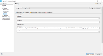

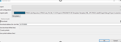

1-Right Click on Template_XIP_AppS(in Apps), [Properties]>[[C/C++ Build]> [Settings] [Build Steps]
2- Tap on the Post-build steps this command: C:\ST\STM32CubeIDE_1.17.0\STM32CubeIDE\plugins\com.st.stm32cube.ide.mcu.externaltools.cubeprogrammer.win32_2.2.0.202409170845\tools\bin\STM32_SigningTool_CLI.exe -bin Template_XIP_AppS.bin -nk -of 0x80000000 -t fsbl -o Project-trusted.bin -hv 2.3 -dump Project-trusted.bin
3-Click on [Apply], then build the Template_XIP_AppS to generate Project-trusted.bin

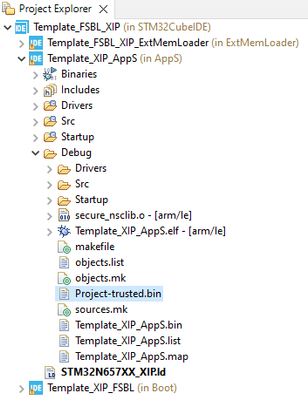

after generating the trusted bin go to
select add in order to add Project_trusted.bin and make sure to choose the download address for the Themplate_FSBL_XIP :0x70100000.
Please check Readme under C:\Users\XXXXX\STM32Cube\Repository\STM32Cube_FW_N6_V1.1.1\Projects\STM32N6570-DK\Templates\Template_FSBL_XIP
