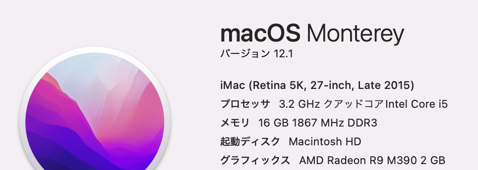

Execution environment is macOS Monterey.
