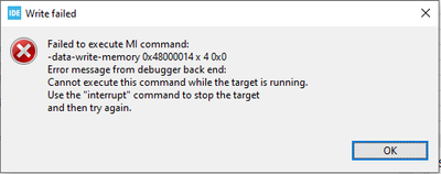

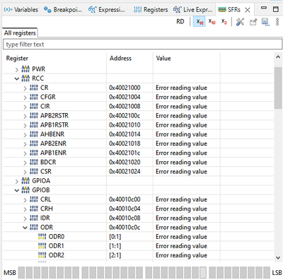

I can't read/change the SFR values while debugging in CubeIDE .
value of all Registers is "error reading value"
If I try to do that IDE throughs and error.
The only way to read/change values is by suspending the debugging session.
I remember this feature was there in CubeIDE or am I missing something?
my stmide version is 1.16.1
2024-11-14 3:30 AM
@Saliwan128 wrote:The only way to read/change values is by suspending the debugging session.
Indeed.
As the message says, you can't do that while the target is running - you have to Halt:
