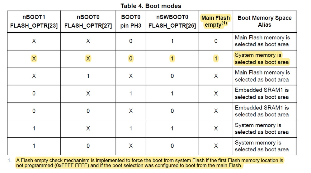

it is a bit clearer. However, the BOOT0 pin is physically connected to GND by a 10k resistor. Looking at boot modes table, it seems I am in the below condition.
Is it possible that debugger erase memory but, at first time, not finding code in flash memory, starts from system memory?
Clicking at stop and run button, the program is downloaded correctly.
