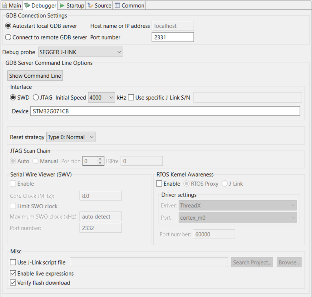

I want to follow the video (https://www.youtube.com/watch?v=Eg_GLvLHM1o&ab_channel=STMicroelectronics) to set up the SWV Viewer, but I am not able to configure the debug configuration, as it is grayed out (like in the picture) and then also the configuration in the SWV Viewers does not appear.
I am using the following system:
Does my chip even support this feature or why is it grayed out?

STM32G0 has Cortex-M0+ core where SWV is not available.
