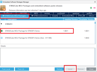

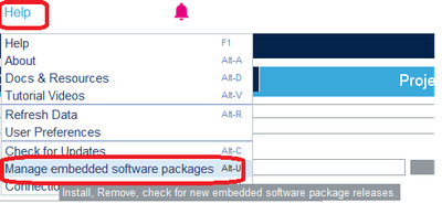

Hello @kgb and welcome to the community.
It seems you are missing the CubeF4 package to generate the code.
Try to go to "Help", then Click on "Manage embedded ..."
In the "STM32Cube MCU Packages" tab, check the latest version of the Cube package and click on Install button
Hope that solves your issue.

@mƎALLEm  Thanks for the solution
