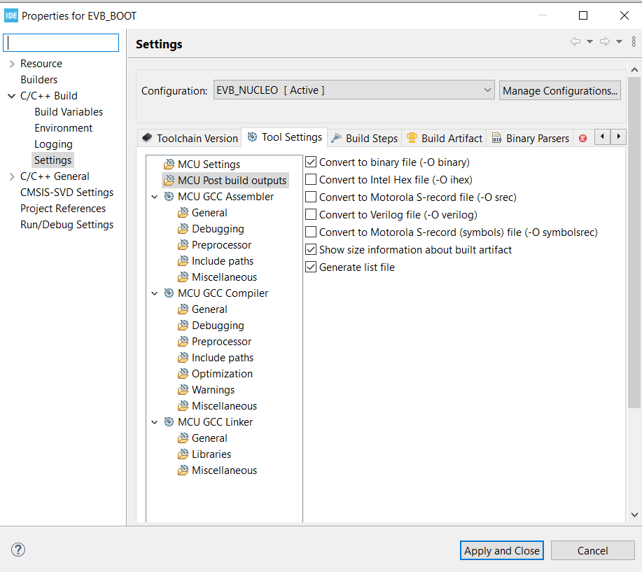

In settings Convert to binary and Show size information are checked, but these actions do not work after successful build.
In Atollic it works fine.
I've tried both STM32 2018 and 2020 toolchains.
Also checked conversion to hex, S-record, verilog - nothing of these created.

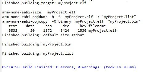

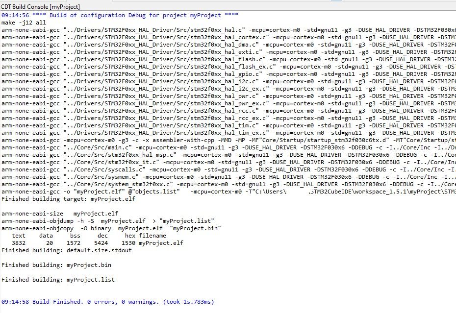

Setup sounds good (default one by the way). Works on my side based on 1.5.1looking at build console:
2021-02-20 12:19 AM
By the way I've no '\\' ... but mutli OS compliant '/' despite relying on Windows OS what's good !
If '\\' I guess part of your project setup (see include paths definition etc ... as part of build settings or just look at your .cproject file content)
