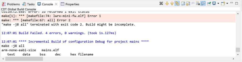

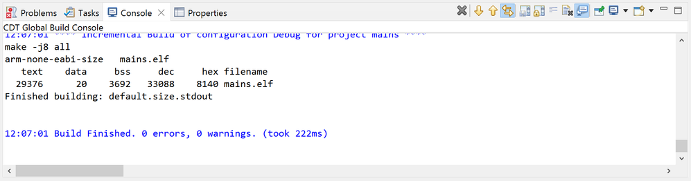

When I do a build in STM32CubeIDE 1.9.0 the console window looks like this:
But if you scroll up a bit...
You can see that the build actually failed. Those errors are real.
I could make the window a bit taller I suppose, but shouldn't it stop building when there is an error, and at least show the error and warning count on the very last line?

You are building multiple projects. That "Build finished" line is only for that project. The build probably does stop building the project with the error, but (obviously) continues with the other projects. Yeah it would be nice if there weer a "grand summary" status at the bottom of the console window. But, if you click on the "Problems" tab you should see any errors listed there from all the projects.

How did you start the build? Were you building multiple configurations, or something...?
Perhaps copy & paste the entire output - so people can see the whole story?
2022-06-21 6:50 AM
I pressed CTRL+B to start the build.
The rest of it is unimportant, but I created a sample for you:
14:49:29 **** Incremental Build of configuration Debug for project lwrx-mini-fw ****
make -j8 all
..\touch.cmd
arm-none-eabi-gcc "../src/main.c" -mcpu=cortex-m4 -std=gnu11 -g3 -DDEBUG -DUSE_HAL_DRIVER -DSTM32F446xx -c -I../Core/Inc -I../Drivers/STM32F4xx_HAL_Driver/Inc -I../Drivers/STM32F4xx_HAL_Driver/Inc/Legacy -I../Drivers/CMSIS/Device/ST/STM32F4xx/Include -I../Drivers/CMSIS/Include -I../src -I../Middlewares/Third_Party/FreeRTOS/Source/include -I../Middlewares/Third_Party/FreeRTOS/Source/CMSIS_RTOS_V2 -I../Middlewares/Third_Party/FreeRTOS/Source/portable/GCC/ARM_CM4F -I../FATFS/Target -I../FATFS/App -I../Middlewares/Third_Party/FatFs/src -O0 -ffunction-sections -fdata-sections -Wall -fstack-usage -MMD -MP -MF"src/main.d" -MT"src/main.o" --specs=nano.specs -mfpu=fpv4-sp-d16 -mfloat-abi=hard -mthumb -o "src/main.o"
arm-none-eabi-gcc "../src/version.c" -mcpu=cortex-m4 -std=gnu11 -g3 -DDEBUG -DUSE_HAL_DRIVER -DSTM32F446xx -c -I../Core/Inc -I../Drivers/STM32F4xx_HAL_Driver/Inc -I../Drivers/STM32F4xx_HAL_Driver/Inc/Legacy -I../Drivers/CMSIS/Device/ST/STM32F4xx/Include -I../Drivers/CMSIS/Include -I../src -I../Middlewares/Third_Party/FreeRTOS/Source/include -I../Middlewares/Third_Party/FreeRTOS/Source/CMSIS_RTOS_V2 -I../Middlewares/Third_Party/FreeRTOS/Source/portable/GCC/ARM_CM4F -I../FATFS/Target -I../FATFS/App -I../Middlewares/Third_Party/FatFs/src -O0 -ffunction-sections -fdata-sections -Wall -fstack-usage -MMD -MP -MF"src/version.d" -MT"src/version.o" --specs=nano.specs -mfpu=fpv4-sp-d16 -mfloat-abi=hard -mthumb -o "src/version.o"
../src/main.c:94:13: error: expected ';' before 'void'
94 | fvjdkfnvkjdf
95 | void vApplicationStackOverflowHook(xTaskHandle *pxTask, signed char *pcTaskName )
make[1]: *** [src/subdir.mk:55: src/main.o] Error 1
make: *** [makefile:67: all] Error 2
"make -j8 all" terminated with exit code 2. Build might be incomplete.
14:49:30 Build Failed. 3 errors, 0 warnings. (took 877ms)
14:49:30 **** Incremental Build of configuration Debug for project mains ****
make -j8 all
arm-none-eabi-size mains.elf
text data bss dec hex filename
29376 20 3692 33088 8140 mains.elf
Finished building: default.size.stdout
14:49:30 Build Finished. 0 errors, 0 warnings. (took 226ms)(I deliberately created that error)

Thanks. Man, I hate Eclipse.
2022-06-22 2:25 AM
Just to add to the great information already provided, Ctrl + B is the binding for "Build All". This means that you would either need to right click your project and select "Close Unrelated Projects" to only have one open project or if you prefer to have multiple projects open but still use Ctrl + B then you can change the binding in "Window -> Preferences -> General -> Keys" to fit your purpose.
2022-06-22 3:04 AM
I always prefer to just right-click the required project, and choose 'Build' - then I always know exactly what it's going to build! :beaming_face_with_smiling_eyes:
