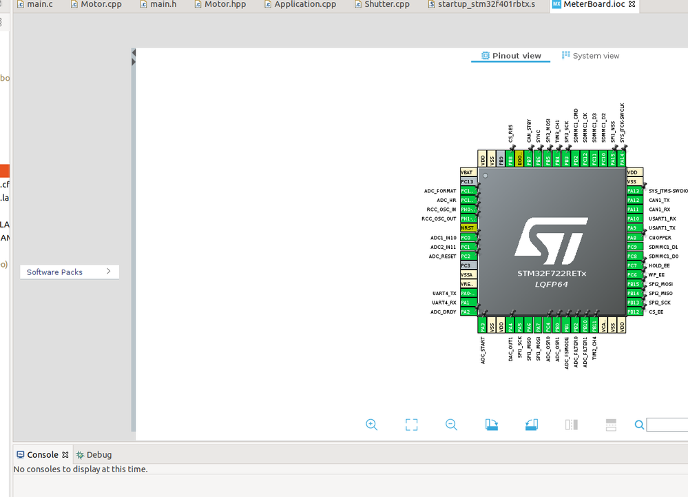

Shortly after starting CubeIDE, if I open a .ioc file, the IDE starts the configurator, but then hangs with the pinout window incomplete and one processor core running 100% indefinitely. I am running CubeIDE 1.6.1 under Ubuntu Linux 18.04.5 on a 2-core processor with 4GB ram.

OK, here you are. I ran the system twice, once when I waited for it to calm down then opened the .ioc, and it behaved correctly. The other where I rebooted first, then opened the .ioc as soon as the project pane appeared, and it hung. I also include a screenshot of the hung IDE. The pin-out pane appears but the peripherals pane to its left does not. I note that the fault seems to occur only after a reboot, once a succesful opening occurs, subsequent IDE runs within that Linux session work OK.

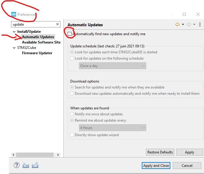

1) Is disabling background updates check is helping ? (Windows > Preferences)

=> Cutting such under the hood update checks may help I guess

Thanks. I'm trying setting update checks to once a week.

I have the same issue. If my PC is under load them opening .ioc hangs. Take a look at left panel on the screenshot. It is empty and IDE hangs. I have to calm down PC and to restart IDE to open .ioc file. I saw this behavior in version of IDE 1.3, 1.4, 1.5, 1.6, 1.7. They all behave the same.
