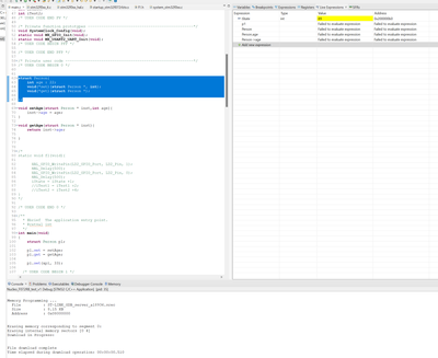

My issue is, that I don't know how to watch the variables defined in functions:
Eg: Variable i inside function f , see second picture.
static void f1(void){
int i = 3;
HAL_GPIO_WritePin(LD2_GPIO_Port, LD2_Pin, 1);
HAL_Delay(500);
HAL_GPIO_WritePin(LD2_GPIO_Port, LD2_Pin, 0);
HAL_Delay(500);

Hello STM_Thirty2,
thanks a lot for your support!
I created a global Struct 'Person'.
But still can't acess the struct in debug-mode via LifeExpression.
What am I doing wrong?
2024-12-02 8:30 PM - edited 2024-12-02 8:35 PM
The struct object is global but your p1 is still a local variable you made it in the main function. This will still work through the life of your program because technically the program always be in the main function , so your issue now is probably you are not really doing anything with p1 , so the compiler is optimizing it out.

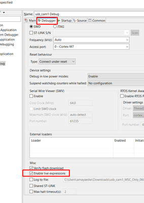

Additionally make sure you have live expressions enabled:

thank you very much for your help, now it works!
