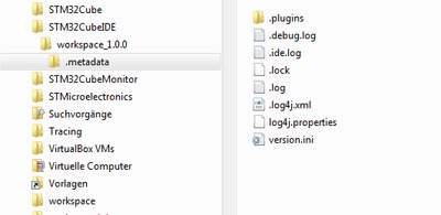

and log file...in workspace, see:
btw You have some free RAM ? IDE needs about 2GB ; + 1GB , when compiler /linker is called .
