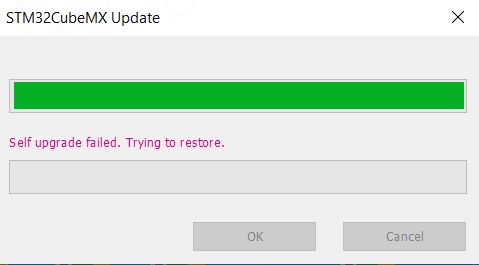

Hi, I'm going crazy over here because the stm32cubeIDE closes itself a few seconds after loading. Literally, I double-click on the icon, the program comes up, and sometimes after 5, 10, or 20 seconds, it closes itself.
After cloasing a small window appears, I attach a picture of it.
I have uninstalled all ST software I had on my PC, installed it again, installed the last versions and previous versions, updated to the last version of Win 10, but nothing works. Cube MX works fine, but the only issue is with this software.

It worked for me. I confirm that your method works to fix this error.
The cause of my error was that I started updating STM32CubeIDE, but I also started updating STM32CubeMX. After that, STM32CubeIDE stopped working and gave the following error:
I followed everything Ahmad M. Nejad wrote, and everything started working for me!

Yeah, exact same thing. Yeah, updating via STM32CubeMX solved the issue. Super annoying and totally not obvious on how to resolve. These are the reasons I generally recommend other tools for application development. To just suddenly start failing to start is a serious problem that should be resolved ASAP.
