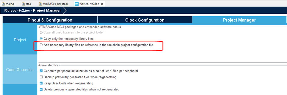

But CubeMX/CubeIDE does give you the option to link rather than copy:

What you want is not supported in the current CubeMX framework. You can add links to folders if you want, and put files there, but there is no "package manager" like feature that will automatically link and download the version of the library you want.
The "Embedded Software Packages" get downloaded into a main repository folder and from there are copied to your project folder on code generation. If you want to do this manually, you can link to the repository folder instead, but this would be a manual step.

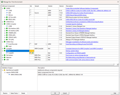

E.g., if I choose a STM32U5xxx and CubeMX support in Keil's package manager, it tells me that CMSIS-Core is required:
I was hoping for something similar in ST's solution.

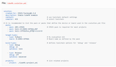

Looks like I will go and use the CMSIS-Toolbox way, see CMSIS-Toolbox and Configure STM32 Devices with STM32CubeMX - CMSIS-Toolbox. Which is open-source and (silicon-) vendor independent BTW.
